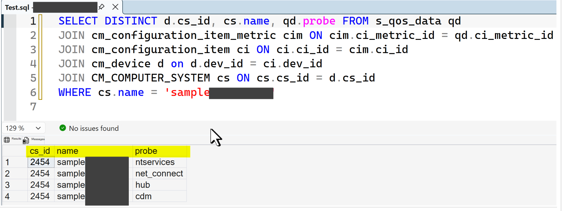

If there is any probe that is monitored by that machine then it has that probe information in the "Monitored By" column. If we deploy just a robot on that machine then it shows that column as Hub otherwise for the machines just discovered using discovery there will not be any entry in the  S_QOS_DATA table. Hence the column will be blank. Please refer to the underlying query below to see the details.
SELECT DISTINCT d.cs_id, cs.name, qd.probe FROM s_qos_data qd JOIN cm_configuration_item_metric cim ON cim.ci_metric_id = qd.ci_metric_id
JOIN  cm_configuration_item ci ON ci.ci_id = cim.ci_id
JOIN  cm_device d on d.dev_id = ci.dev_id
JOIN CM_COMPUTER_SYSTEM cs ON cs.cs_id = d.cs_id
WHERE cs.name = '<machine_name>'
