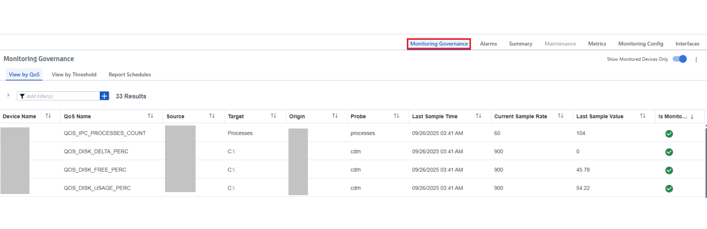

Monitoring Governance provides comprehensive and transparent information about individual devices or groups.
In the OC->Inventory, then select a device or group-> then select Monitoring Governance
Screenshot example below:
