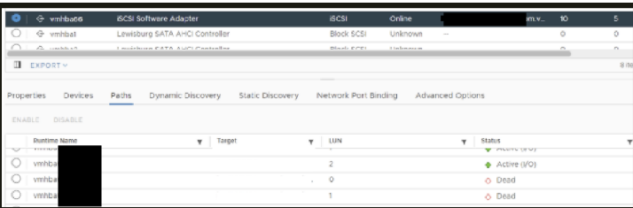

While attempting to connect to a configured iSCSI storage target array, the iSCSI initiator is unable to establish a connection.
    • The vSphere Client displays: Login to iSCSI target iqn.#### on vmhba## failed. The iSCSI initiator could not establish a network connection.
    • In /var/log/vobd.log, events similar to the following appear: [iscsiCorrelator] [vob.iscsi.target.connect.error] vmhba## @ vmk# failed to login to iqn.#### because of a network connection failure. [iscsiCorrelator] [vob.iscsi.target.async.event] The target iqn.#### issued an async event for vmhba## with reason code 0003
    • Storage adapter paths show a state of "Dead" or "Offline".
  • Datastores may enter "All Paths Down" (APD) state.
