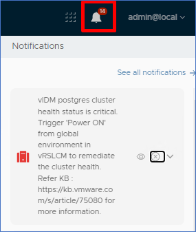

    1. Login to VMware Aria Suite Lifecycle and validate the Global Environment Health.
    2. Trigger a Postgres Cluster health.
    3. Confirm there is no Health Notification.
      1. If one exists, access the notification pane and confirm if the problem is due to the root password not updated in Locker. If required, remediate the passwords following Remediating passwords updated outside of VMware Aria Suite Lifecycle.
      2. If the root password is updated in Locker, Troubleshooting VMware Identity Manager postgres cluster deployed through vRealize Suite Lifecycle Manager
    4. If you receive a message similar to the image below, validate the config-state.json file is not corrupted by following instructions found in HW-134096 - VMware Identity Manager Connector may fail to communicate due to config-state.json corruption.
