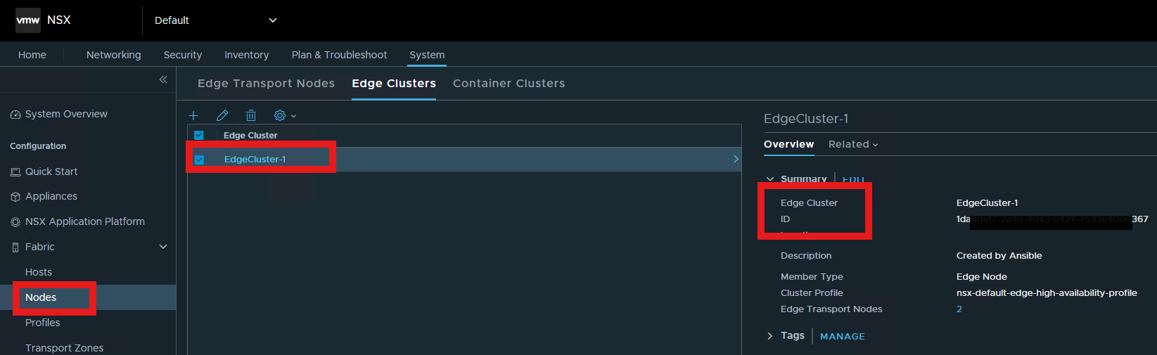

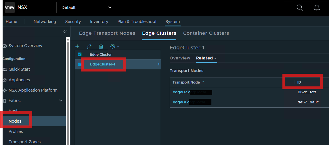

Use following API to collect the details and use it in above command :
 GET https://<policy-mgr>/api/v1/edge-clusters
<edge-cluster-id>
<edge-node-id>
<member_index> for each edge
 [or]
Find the same from NSX manager GUI :
