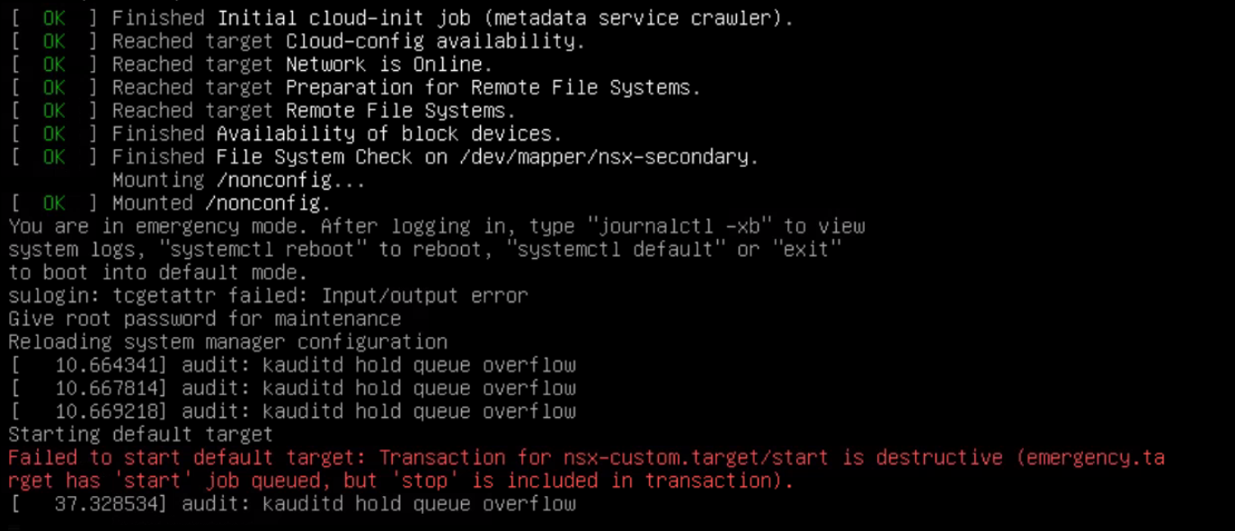

  • When opening the NSX VM console, the following error is displayed:
VMware NSX-T Data Center 3.x
