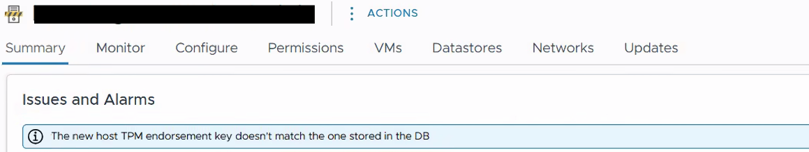

After changing the system board with TPM or the RoT(Root of Trust) module, the following message may appear within the vSphere Client or ESXi host summary page:
The new host TPM endorsement key doesn't match the one stored in the DB
