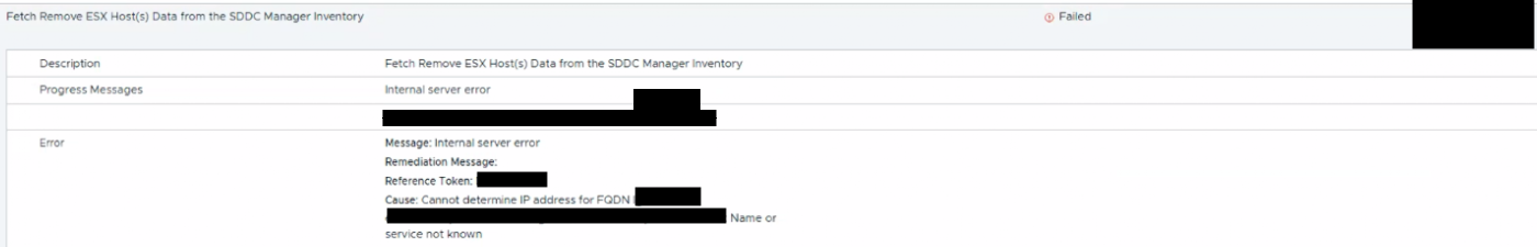

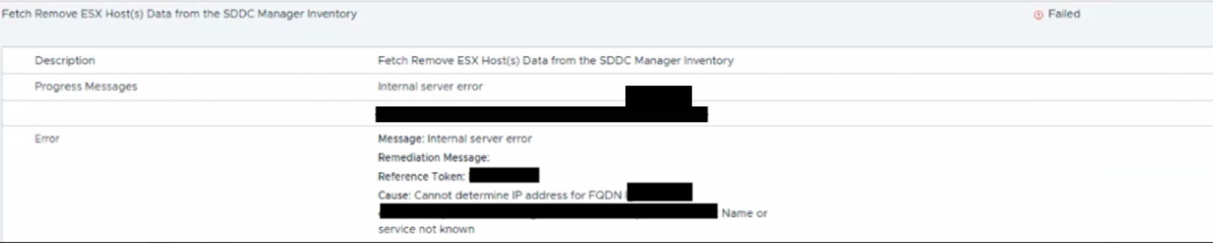

  • Failed to decommission the host. The attempted functionality HOST_DECOMMISSION is not supported in the current system state. Function requires a context id, but was unable to calculate one.
  • Internal server error: Fetch Remove ESX Host(s) Data from the SDDC Manager Inventory cause being: Cannot determine IP address for FQDN
