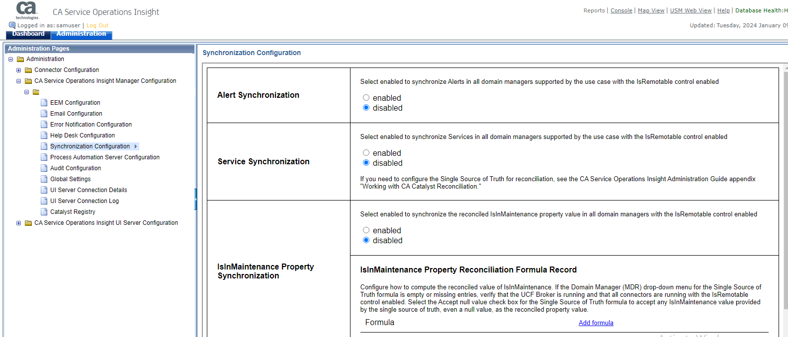

3. Copy the existing Synchronization Configuration settings. This step is required because these settings will need to be restored manually in the new instance.
    Go to your Administrator Page: http://<SOIMANAGER>:7070/sam/ui/ > Administration > Expand the Manager node > select "Synchronization Configuration"
     Screenshot this page so you can remember the existing setting.

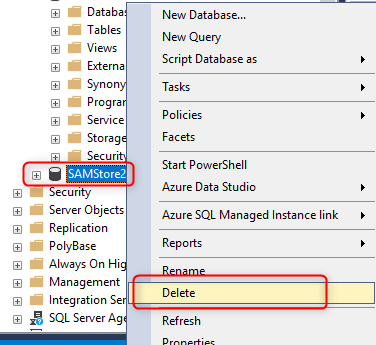

9. Using SQL Management Studio, Delete the new DB Schema ceated (Eg. SAMstore2).

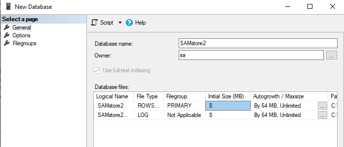

10. Create a new DB and name it similarly to the DB that has been created during the install and then deleted in point 9).  (Eg. SAMstore2).
(Set the same ownership as the SAMstore, Eg. "sa")

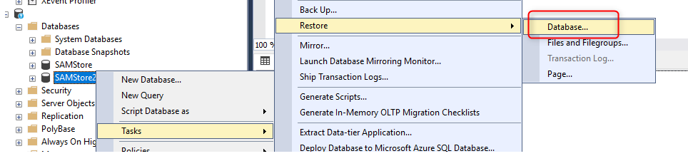

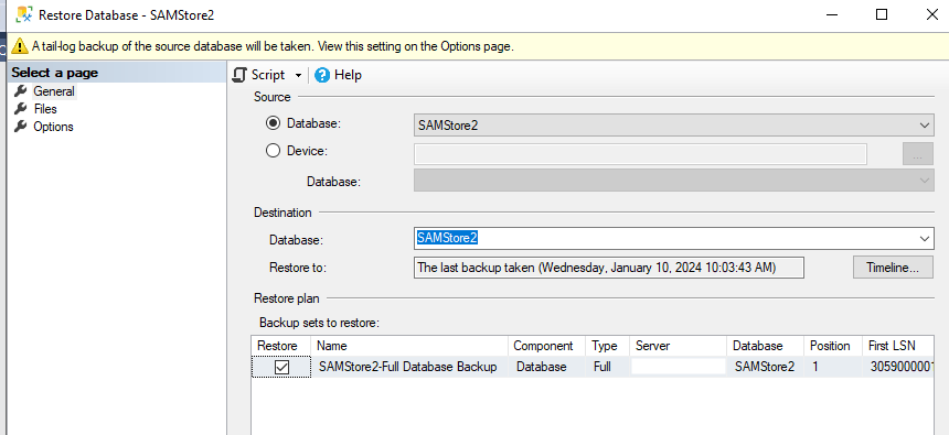

11. Restore the backup taken (SAMstore.bak) into the new empty DB Created.  (Eg. SAMstore2).
Task > Restore > Database

14. Restore the "Synchronization Configuration" settings from the administration page. (The services will restart if changes will be added)
