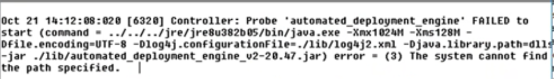

So after resolved the above issues , customer started doing the installation again , they re-run the installer but this time again its stuck with ADE probe configuration at 43 %
Below error getting:-
UIM UIM 20.4
Follow the below step:-
== Remove the high version of ADE and Java_JRE from Archieve
== Deploy the ADE 20.41 & Java_jre 2.09
