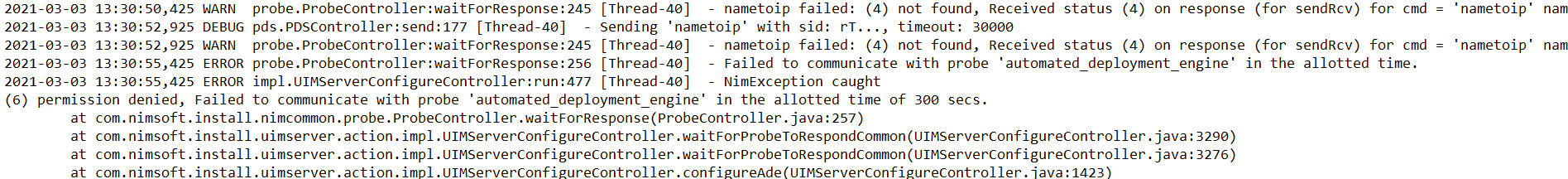

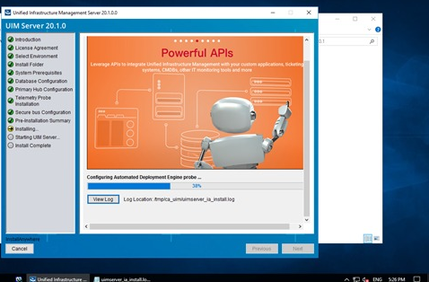

While upgrading from UIM 9.0.2 to UIM 20.1 following error is encountered.
UIM error for automated deployment engine probe failed to start
Can see below error in UIM installation logs

Now re-run the install
Note :In the scenario if UIM installation is started and observed that new jre gets extracted and then deleted in the uim jre folder
If this occurs then manually extract the java_ jre in the nimsoft jre folder
Start IM and deactivate/activate the automatic_deployment_engine
Rerun the UIM 20.1 installer
