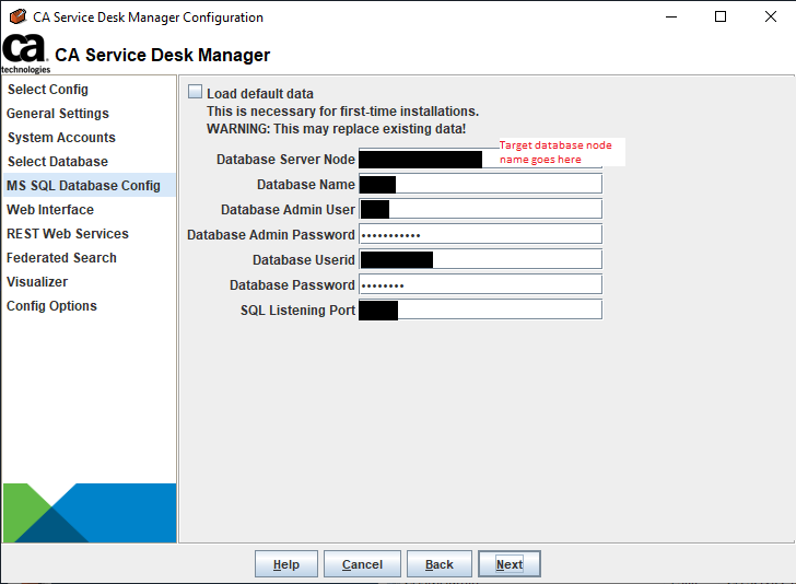

9. For SDM: run pdm_configure and point to the target database.
