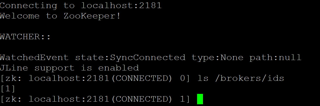

ls /brokers/ids
Expected results: It displays the number of kafka brokers connected to zookeeper
If you have a medium elastic deployment, the result should be: [0, 1, 2] as below:
If you have a single elastic deployment and you see only 1 broker:
Recommendations:
