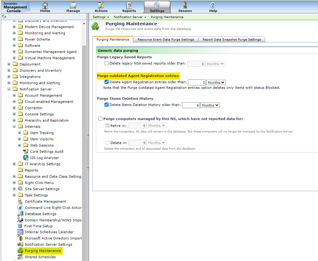

  2. Check if this client machine is been purged because of falling under the purging criteria for the "Purge outdated Agent Registration entries" option.
