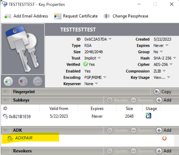

When the ADK for an organization is going to expire, the key should be reviewed immediately.  As per the ADK Guidelines, it is not recommended to have an ADK to expire.  One major reason for this is when an ADK is configured on the PGP Server for the organization, the ADK is then automatically added to end user's individual keys.
When the ADK is added to the user's keys, any subsequent encryption tasks will encrypt to the specified list of keys the user provides, and will also automatically encrypt to the ADK.

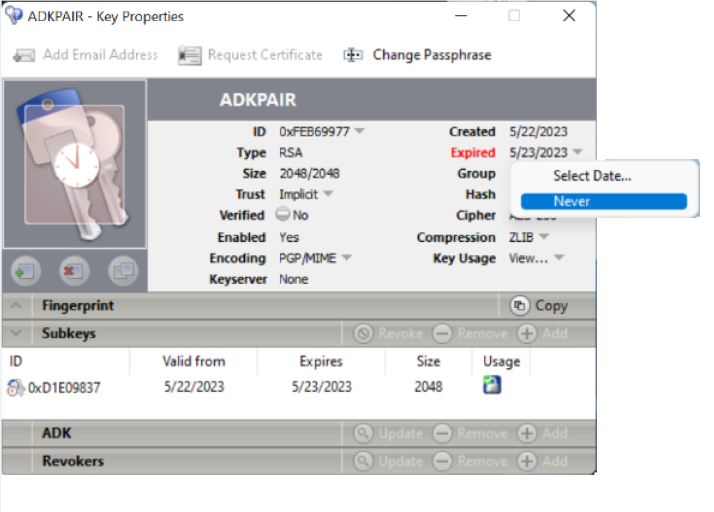

Consider the following screenshot where the ADK is expired:
As you can see, there is a "Clock" overlay icon on the key, which means the key is expired.

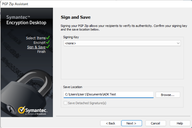

Click OK, to this dialog box, and output the file to a location that is convenient:
Notice that it is not possible to encrypt because the ADK has expired:

Import the Keypair of the ADK and then in the Keys, double-click on the key itself, then click the "Expired" drop down and select "Never" so the key will never expire in the future.

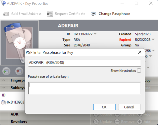

You will need to enter the passphrase of the ADK:

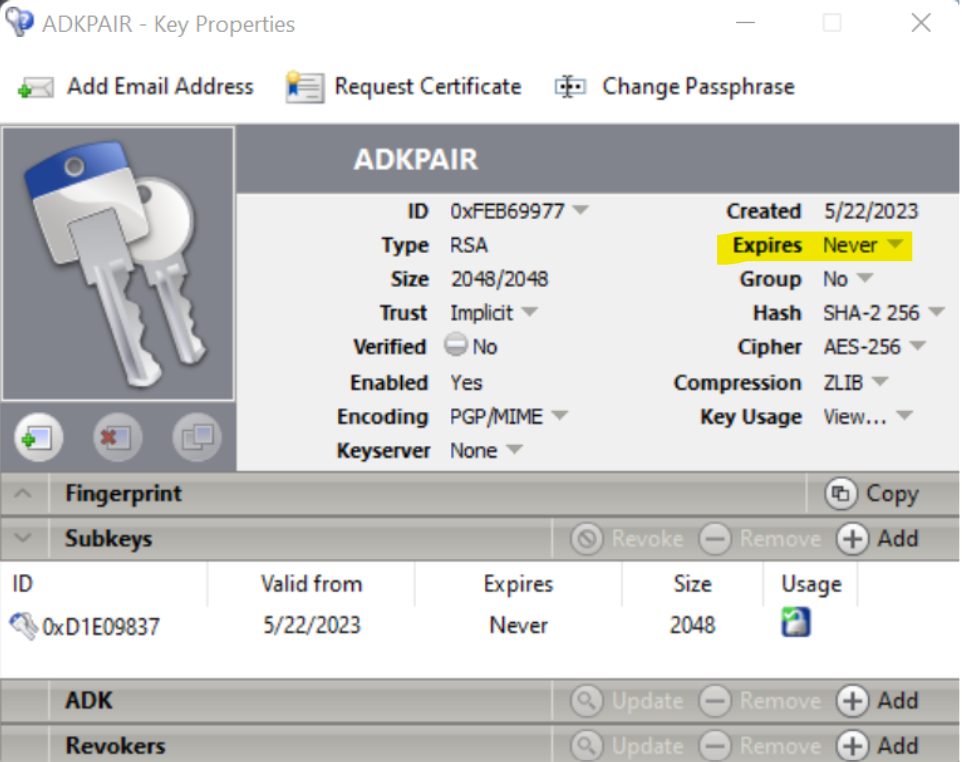

Once this is done, the key will then be set to "Never" for the expiration date:
Now when you go to encrypt, the ADK will now be usable:
