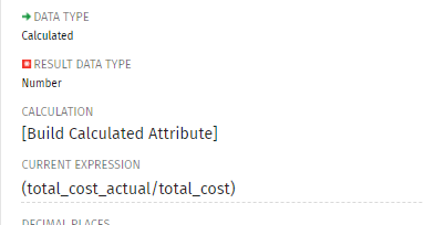

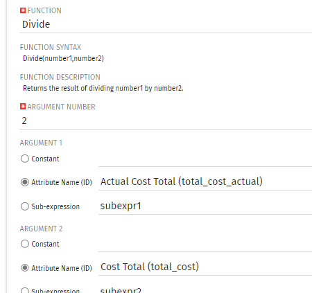

Here is what you can do to create a copy of the % Spent field:
1. Go to Studio > Objects > Cost Plan details object > Attributes tab
2. Create a calculated attribute: (total_cost_actual/total_cost)
3. Add the resulting calculated attribute to the Cost Plan Details list view
4. Go to the Cost Plan Details list view > Fields and change the display type to Calculated percent
