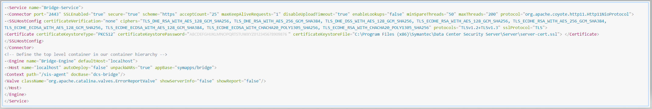

3. Open the backup server.xml that was used prior to the upgrade and remove the bridge-service portion of the server.xml file.
-<Service name="Bridge-Service">
-<Connector port="2443" SSLEnabled="true" secure="true" scheme="https" acceptCount="25" maxKeepAliveRequests="1" disableUploadTimeout="true" enableLookups="false" minSpareThreads="50" maxThreads="200" protocol="org.apache.coyote.http11.Http11NioProtocol">
-<SSLHostConfig certificateVerification="none" ciphers="TLS_DHE_RSA_WITH_AES_128_GCM_SHA256, TLS_DHE_RSA_WITH_AES_256_GCM_SHA384, TLS_DHE_DSS_WITH_AES_128_GCM_SHA256, TLS_ECDHE_RSA_WITH_AES_128_GCM_SHA256, TLS_ECDHE_RSA_WITH_AES_256_GCM_SHA384, TLS_ECDHE_ECDSA_WITH_AES_128_GCM_SHA256, TLS_ECDHE_ECDSA_WITH_AES_128_GCM_SHA384, TLS_ECDHE_ECDSA_WITH_CHACHA20_POLY1305_SHA256, TLS_ECDHE_RSA_WITH_CHACHA20_POLY1305_SHA256" protocols="TLSv1.2+TLSv1.3" sslProtocol="TLS">
<Certificate certificateKeystoreType="PKCS12" certificateKeystorePassword="j9brwdpa8Uhn1qjPWtNhpiT3KfR0xASfOljPYLxJ" certificateKeystoreFile="C:\Program Files (x86)\Symantec\Data Center Security Server\Server\server-cert.ssl"> </Certificate>
</SSLHostConfig>
</Connector>
<!-- Define the top level container in our container hierarchy -->
-<Engine name="Bridge-Engine" defaultHost="localhost">
-<Host name="localhost" autoDeploy="false" unpackWARs="true" appBase="symapps/bridge">
<Context path="/sis-agent" docBase="dcs-bridge"/>
<Valve className="org.apache.catalina.valves.ErrorReportValve" showServerInfo="false" showReport="false"/>
</Host>
</Engine>
</Service>
4. Save the file and place it back in the <install Directory>\Symantec\Data Center Security Server\Server\tomcat\conf\ directory.
