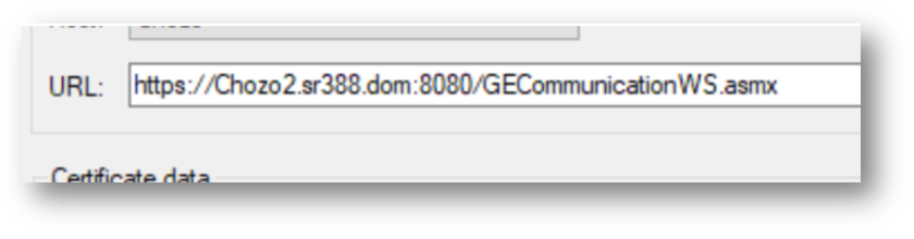

In the screenshot above, for this example, we have "server1.example.com" and "server2.example.com".
The existing client is pointed to "server1.example.com", so from the list, you can select "server2.example.com.
Confirm the URL for communications is correct. In this case, we'll call it "server2.example.com":
Choose whatever port you have. In most cases, https will be port 443. In this example, 8080 is being used just for testing purposes.
Under the "Certificate Data" section, if you are not changing the certificate, this will be empty. The only time this would change is if a new certificate is added.
If a new certificate is updated, be careful about changing the Root Certificate. This page could be used to update the certificate, but may be best to consult with Symantec Encryption Support if this is the needed.
If only the server certificate changes, typically there is no need to update this page.
