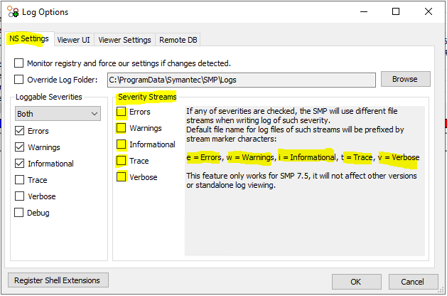

In order to turn these "Severity Streams" type of NS logs, you need to go under the Altiris log viewer > Options > Log Options > NS Settings tab. Under the Severity Streams section, you may see the available options that you can turn on.
https://api-broadcom-ca.wolkenservicedesk.com/attachment/get_attachment_content?uniqueFileId=771ba4aJ2Ck3rDGNb4x1jg==
As the Altiris log viewer UI says:
If any of severities are checked, the SMP will use different file streams when writing log of such severity.
Default file name for log files of such streams will be prefixed by stream marker characters:
e = Errors, w = Warnings, i = Informational, t = Trace, v = Verbose
All these logs will be saved under the default NS log location "C:\ProgramData\Symantec\SMP\Logs"
As mentioned, these are a copy of the regular "Severity" logs that you have turned on, when turned on both types (Loggable Severity and Severity Stream), we create a separate copy of these "severity Type" as an unique entry for review later on.
We use these "Severity Streams" logs when we are troubleshooting an issue and we are concern that we may overwrite the logs when we can't review the NS logs in the same period of time when the issue occurs. For example, if I need to capture "Trace" log verbosity because an issue occurs at 3am and I know I can't grab the NS logs at that time and usually the NS logs are overwritten too quickly because other messages are coming in, we come to the Altiris log viewer, check the box for "Trace" loggable Severity and also the "Trace" severity stream.
https://api-broadcom-ca.wolkenservicedesk.com/attachment/get_attachment_content?uniqueFileId=UZDBsvw/EzyHcxIazxw+nw==
In that way, the NS logs will add the "Trace" level entries to what we are logging in and we create a separate "ta" NS log keeping all the "Trace" type log in a separate log file that can be reviewed later on.
