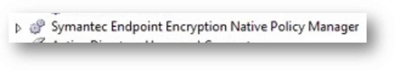

You will also want to check out the "Symantec Endpoint Encryption Native Policy Manager":
This is where you will be creating separate SEE Policies. Once you have a Policy creating, you can right-click on the group you want machines to show up in and then assign the group to a policy.
