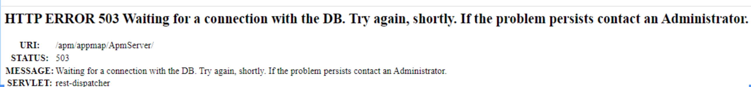

Unable to log in, error "HTTP ERROR 503 Waiting for a connection with the DB. Try again, shortly"
Article ID: 235315
DX APM SaaS DX Application Performance Management DX OI SaaS DX Operational Intelligence DX Operational Observability DX SaaS
The following error is reported when trying to access to the UI: HTTP  Error "HTTP ERROR 503 Waiting for a connection with the DB. Try again, shortly"
DX Operational Observability (DX O2) OnPrem
apmservices-apmbacking or some other dx services are not running as expected.

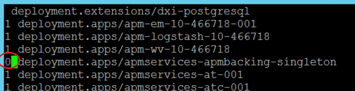

Example 1:
Below example, illustrating an issue with "apmservices-apmbacking-singleton" , by mistake it has been configured with replicas 0 .
vi <dx-platform-home>/tools/dx-admin.data
ACTION TO TAKE: edit the file, change the 0 replicas to 1, then  stop and restart all services again

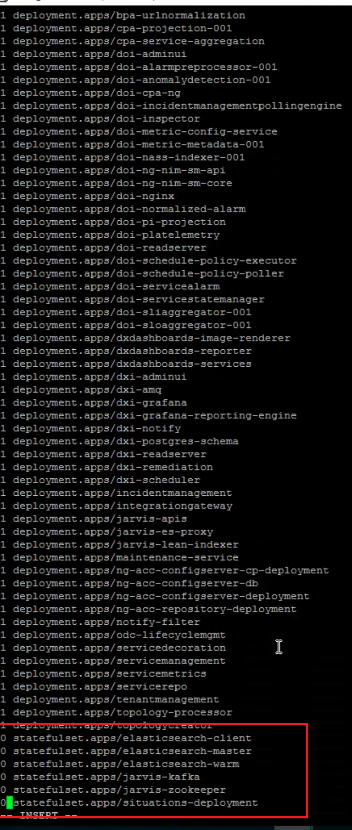

Example 2: below another example, illustrating the same issue, in this case multiple jarvis and doi services have been configured with replicas 0 incorrectly.
ACTION TO TAKE: update replicas to 1 for elasticsearch-master, jarvis-kafka, jarvis-zookeeper, situations-deployment , then restart all services again. (NOTE: elasticsearch-client and elasticsearch-warm replicas is by default 0, check with your team these #s needs to be manually corrected)
