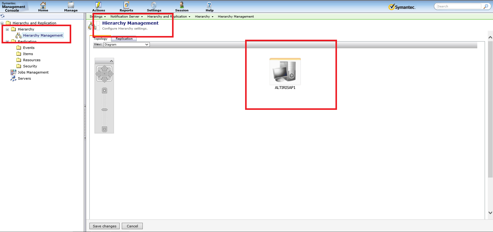

ITMS 8.x
Incorrect entry in the registry
Verify the following:
1. Make sure you don't have a hierarchy setup (SMP Console>Notification Server> Hierarchy
2. If you don't have a Hierarchy, check under HKEY_LOCAL_MACHINE\SOFTWARE\Altiris\AIM\ for "HierarchyReplicationEnabled" regkey. It should be set to "False".
Also, check for "NTierHierarchyEnabled" regkey. It should be set to "False".
Note:
If everything looks fine and no other indication of Hierarchy is setup, Enable the Next Button for the Install Readiness Check
