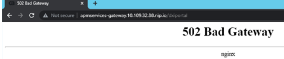

We added a 2nd nic to the k8s master server:
- one nic for k8s communication
- one nic for management
after adding the 2nd nic we are no longer able to open the DX Admin login page, we get "502 Bad Gateway" error message
we tried restarting dxi using <dx-platform>/tools/dx-admin.sh stop/start but it didn't help
we can see many axa-services pods are unable to startup and remain in "Init" status
