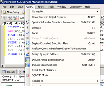

  2. In SQL Manager, Turn on the following statistics from the "Query" menu (as shown in Figure 1):
    "Include Actual Execution Plan"
    "Include Client Statistics"
    Figure 1:

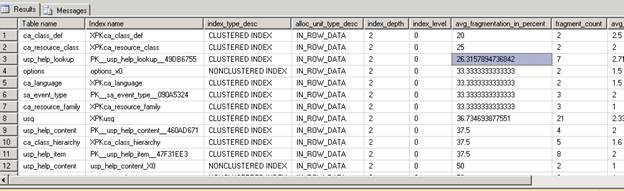

Looking for Fragmentation on Indices
There's a general consensus that you should reorganize ("defragment") your indices as soon as index fragmentation reaches more than 5 (sometimes 10%), and you should rebuild them completely when it goes beyond 30%
Sample Script for seeing how fragmented the indices are:
SELECT t.NAME 'Table name', i.NAME 'Index name', ips.index_type_desc, ips.alloc_unit_type_desc, ips.index_depth, ips.index_level, ips.avg_fragmentation_in_percent, ips.fragment_count, ips.avg_fragment_size_in_pages, ips.page_count, ips.avg_page_space_used_in_percent, ips.record_count, ips.ghost_record_count, ips.Version_ghost_record_count, ips.min_record_size_in_bytes, ips.max_record_size_in_bytes, ips.avg_record_size_in_bytes, ips.forwarded_record_count FROM sys.dm_db_index_physical_stats(DB_ID(), NULL, NULL, NULL, 'DETAILED') ips INNER JOIN sys.tables t ON ips.OBJECT_ID = t.Object_ID INNER JOIN sys.indexes i ON ips.index_id = i.index_id AND ips.OBJECT_ID = i.object_id WHERE AVG_FRAGMENTATION_IN_PERCENT > 0.0 ORDER BY AVG_FRAGMENTATION_IN_PERCENT, fragment_count
Sample output in Figure 2 below:
Figure 2:

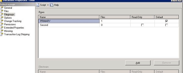

  • Auto Shrink / Auto growth
    If these are not set appropriately, and the size of the data files changes frequently, this will cause delays.
    For certain tables it may make sense, to put those tables on their own disk or file group. The speed of the disks should be looked at.
    For example, using MS SQL (as shown in Figure 9):
    USE [master]
    GO
    ALTER DATABASE [MDB] ADD FILEGROUP [Second]
    GO
    Figure 9:

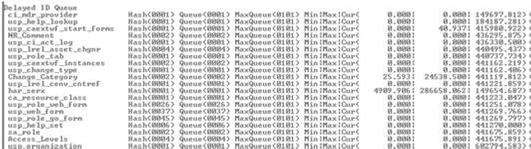

    The pdm_vdbinfo report also includes a Delayed ID Queue section, which identifies the "select short" cache usage. A select short query is one that has the WHERE clause of "WHERE id=?" and only returns one row. Consider the following example (in Figure 11):
    Figure 11:
    This listing displays any table that is accessed as part of a select short query. For each table entry, the following information appears:
  • Hash -Reserved for developer use only.
  • Queue -Indicates the actual number of select short responses that are currently queued. If the queue "wraps," this number equals the MaxQueue value. A queue is limited to its MaxQueue value. On the MaxQueue +1 select short query, the oldest query is dropped and the queue wraps.
  • MaxQueue -Configures maximum length of the queue for this table. The default value is 101 rows.
  • Min -Indicates the shortest time the queue has taken to wrap since the bpvirtdb_srvr process started. If the queue has not wrapped, this value is 0 (zero).
  • Max -Indicates the longest time the queue has taken to wrap since the bpvirtdb_srvr process started. If the queue has not wrapped, this value is 0 (zero).
  • Cur -Indicates the age of the oldest entry in the queue. If both Min and Max values are 0 (zero), this value is the amount of time since the table was first referenced.
  • When an update occurs, the queue should not wrap until all the domsrvr processes have requested the update. A good rule is to keep the Min value greater than two seconds. If the Min value is greater than two, increasing the number of queued entries only increases memory usage and does not improve performance.
