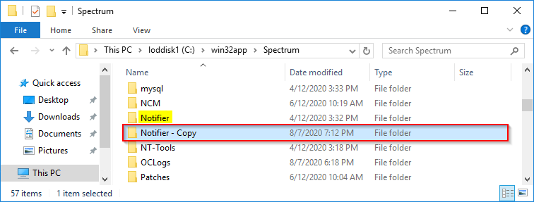

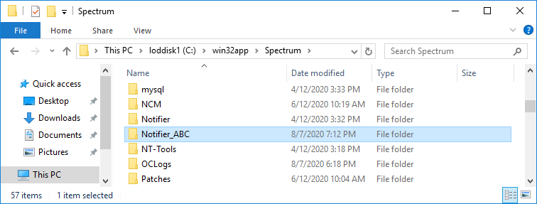

1. Make a copy of the existing $SPECROOT/Notifier/ directory.
2. Rename it to the desired name.

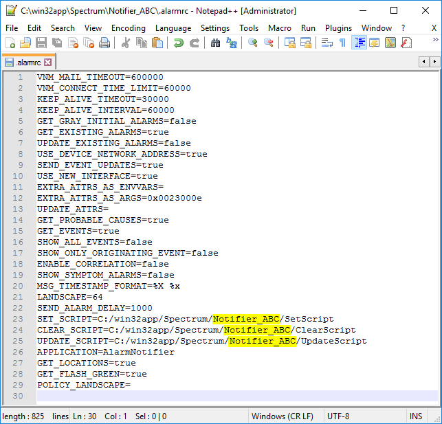

3. Edit the $SPECROOT/Notifier_ABC/.alarmrc file, and change the path of the SET_SCRIPT, CLEAR_SCRIPT, and UPDATE_SCRIPT variables.

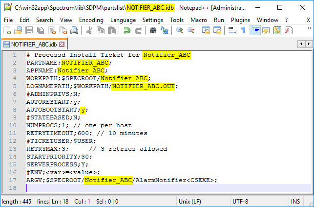

4. Using the $SPECROOT/lib/SDPM/partslist/ALARMNOTIFIER.idb file as a template, create the $SPECROOT/lib/SDPM/partslist/NOTIFIER_ABC.idb file and edit it as follow:
# Processd Install Ticket for Notifier_ABC
PARTNAME;NOTIFIER_ABC;
APPNAME;Notifier_ABC;
WORKPATH;$SPECROOT/Notifier_ABC;
LOGNAMEPATH;$WORKPATH/NOTIFIER_ABC.OUT;
#ADMINPRIVS;N;
AUTORESTART;y;
AUTOBOOTSTART;y;
#STATEBASED;N;
NUMPROCS;1; // one per host
RETRYTIMEOUT;600; // 10 minutes
#TICKETUSER;$USER;
RETRYMAX;3; // 3 retries allowed
STARTPRIORITY;30;
SERVERPROCESS;Y;
#ENV;<var>=<value>;
ARGV;$SPECROOT/Notifier_ABC/AlarmNotifier<CSEXE>;

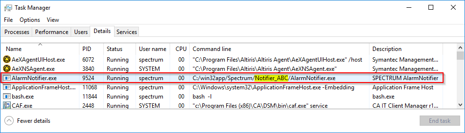

6. The AlarmNotifier process located in $SPECROOT/Notifier_ABC/ directory shows up in Windows Task Manager
