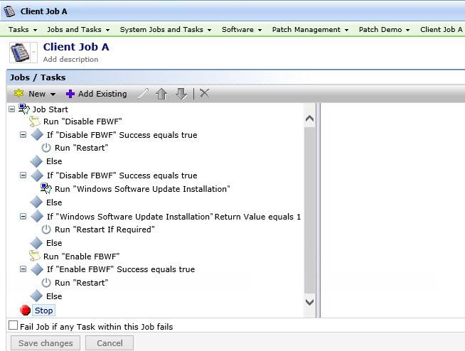

Sample client jobs with a Windows Software Update Installation task
A. If you want to disable the File Based Write Filter (FBWF) for Windows Embedded before software update installation, you can create a client job with the following tasks:
  1. A script task to disable the FBWF.
  2. A power control task to restart target client computers.
  3. A Windows Software Update Installation task to install software updates.
  4. A power control task to restart target client computers if required after software update installation.
    Note: Depending on task configuration, you may need to add a condition to the power control task that is based on the Windows Software Update Installation task return codes 1 or 6.
  5. A script task to enable FBWF.
  6. A power control task to restart target client computers.

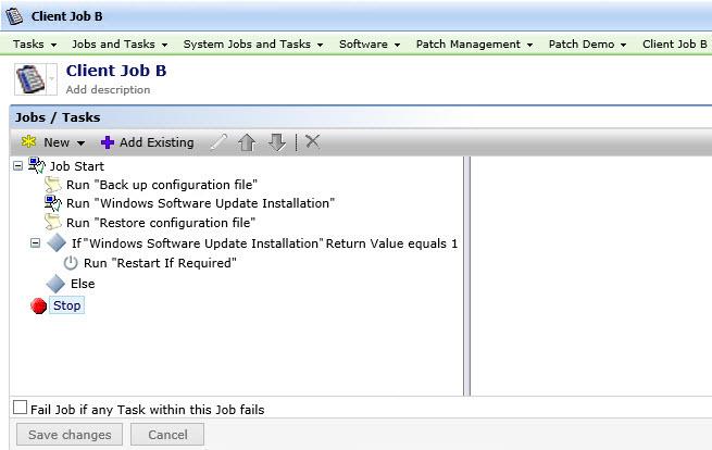

B. If you want to back up configuration file before software update installation, you can create a client job with the following tasks:
  1. A script task to back up a configuration file.
  2. A Windows Software Update Installation task to install software updates.
  3. A script task to restore a configuration file.

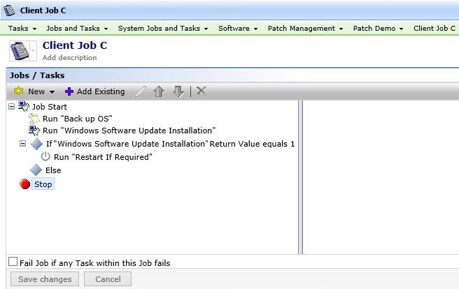

C. If you want to perform an operating system back up before software update installation, you can create a client job with the following tasks:
  1. A script task to back up an operating system.
  3. A power control task to restart target client computers if required after software update installation.
