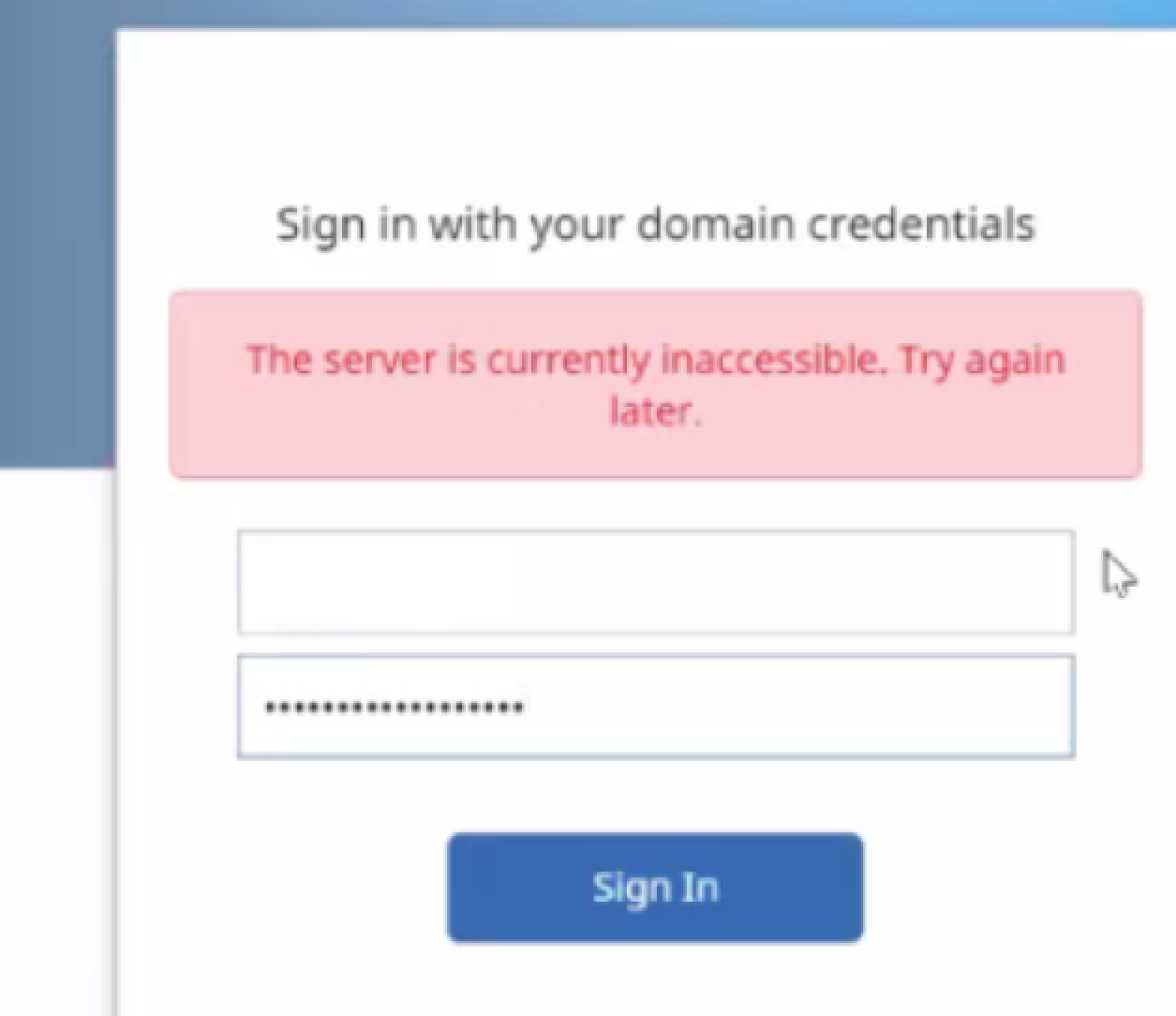

When trying to either use reports, use the Web Console for Symantec Endpoint Encryption, you may receive an error that the server is not responding.
Upon trying to login to the Helpdesk you may see the following errors:
"Service is temporarily unavailable. Contact your administrator"
"The server is currently inaccessible.  Try again later"
You may even receive an error about "Database Access Error" trying to perform reporting functions.

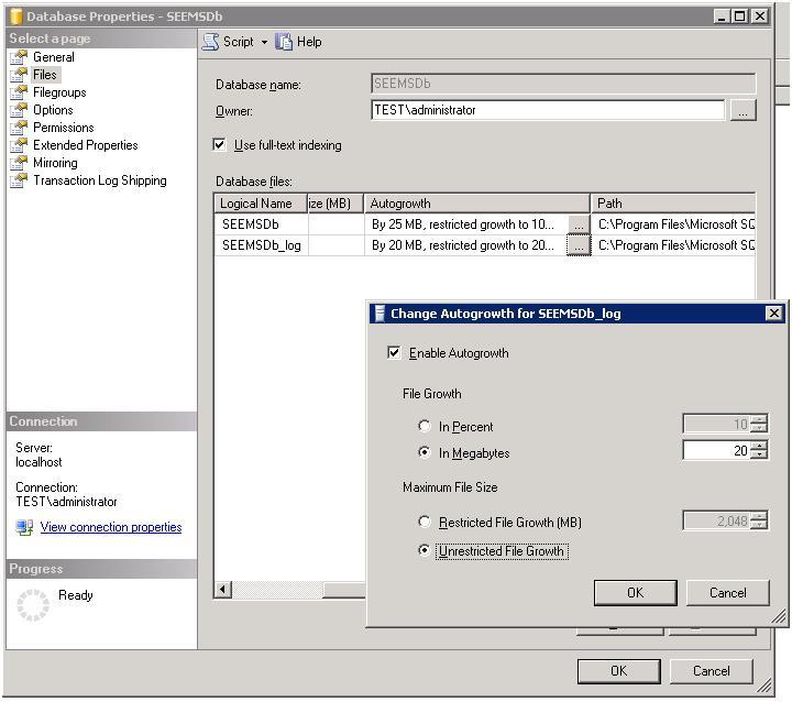

Set Autogrowth to "Unrestricted"
1.       In SQL Server Management Studio, right click on the SEEMSDB database.
2.       Go to Properties.
3.       Then go to the Files section.
4.       Click on both the data and log autogrowth column (Click the ...)
5.       Select “ Unrestricted File Growth
Note : This also applies for the error : "Transaction log for database SEEMDb is full"
In order to do the above, you will need to have proper access to the database.  Work with your Database team to help resolve these types of issues.
