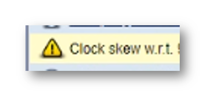

The PGP Encryption Server needs to have the same time on each of the cluster servers.  If you have configured "Local time", it's possible there could be clock skew, such as the following cluster log entry:
Using an NTP server is a good idea to ensure the PGP Server are all going to have the same time.
