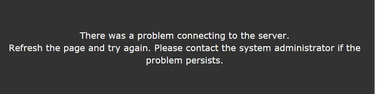

Attempts to use xFlow Analyst UI or Service Point URL results in an error in the browser window:
"There was a problem connecting to the server. Refresh the page and try again. Please contact the system administrator if the problem persists"

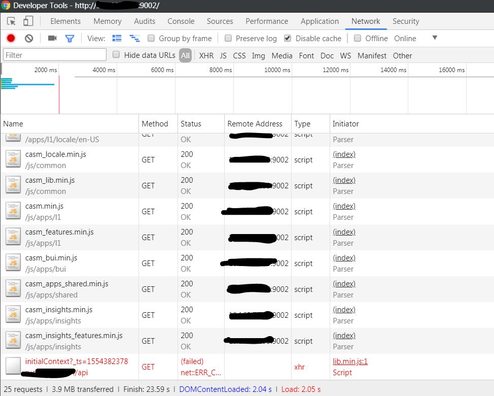

c)  Each of the URLs above should be accessible via the web browser for xFlow/Service Point to function properly.
d) One option to identify if these URLs are available or not, is to use a browser's Debug/Developer tools.  The below example shows this for Chrome browser, but similar steps are needed for Firefox and Internet Explorer:
1.  Clean up browser cache
2.  Attempt to use xFlow/Service Point login page and wait for the error to occur
3.  Within the same browser window, launch Chrome Developer Tools / Console by using the keyboard's F12 function key
4.  Select Network tab on the console
5.  Refresh the xFlow/Service Point login page again, this forces the browser to retry the connection again
6.  Either the Console tab or the Network tab with in the debug tools console should give an indication if any of the above URLs were available to the web browser or not
e) If those URLs are not available to the web browser, it causes the error "There was a problem connecting to the server. Refresh the page and try again. Please contact the system administrator if the problem persists".  The example below shows that the web browser was originally getting content, but then attempted to obtain content from another URL (it is one of the URLs listed in the casm.conf.js file. It is usually the server name listed in the "api" section of the file)
1.  To fix the issue, fix the casm.conf.js (take a backup of the original file first) to have correct entries for all the server URLs listed.  Each of those URLs should be available to the web browser.
2.  Restart xFlow service and retest
