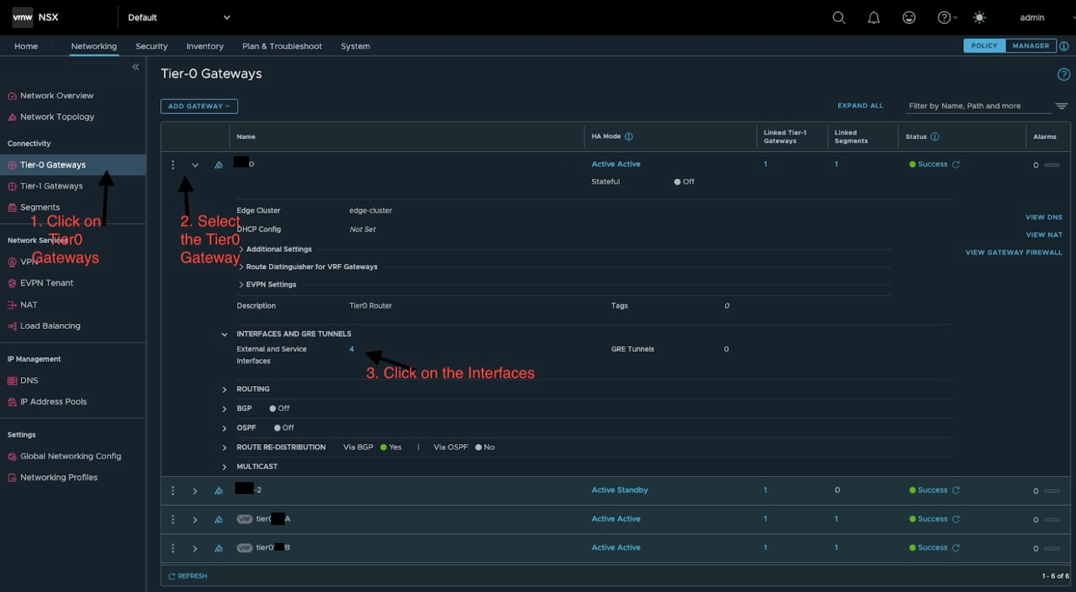

    3. Check NSX Edge Tier0 uplink VLAN: Create a Tier-0 Uplink Segment
