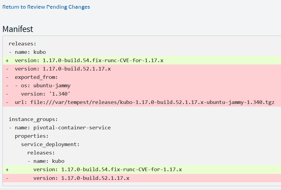

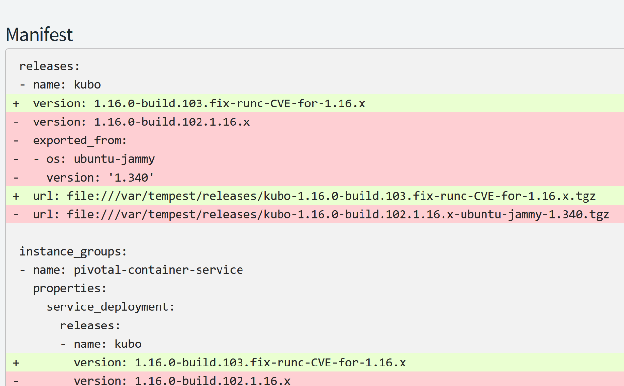

Review Pending Changes
Login to the Opsmgr UI and click Review Pending Changes -> See Changes. The screenshots below highlight what to expect in terms of differences for your respective version.
TKGI 1.18.x
TKGI 1.17.x
TKGI 1.16.x
