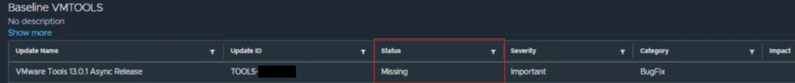

  • In vCenter, a remediation task completes without error, however the status for the baseline shows a status of "Missing".
