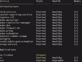

  • vracli service status returns vco Degraded:
VCF Operation/Automation formerly VMware Aria Automation Orchestrator formerly VMware vRealize Orchestrator 8.9.1, 8.x
