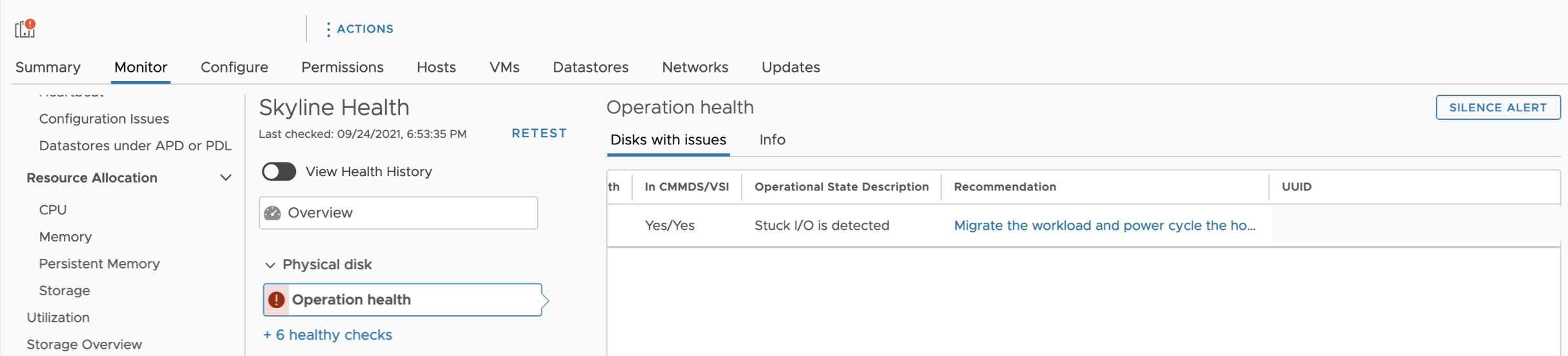

Check for Skyline Health Alarm "Operation Health" via SSH/Putty to any of the vSAN Hosts:
Run the following command:
esxcli vsan health cluster get -t 'Operation health'
Example of output:
Operation health red
Host      Disk      Overall health Metadata health Operational health In CMMDS/VSI OperationalState Description Recommendation UUID
HOSTNAME  Disk(xxx) red            red             red                Yes     /Yes                  Stuck I/O is detected Migrate workload & power cycle host

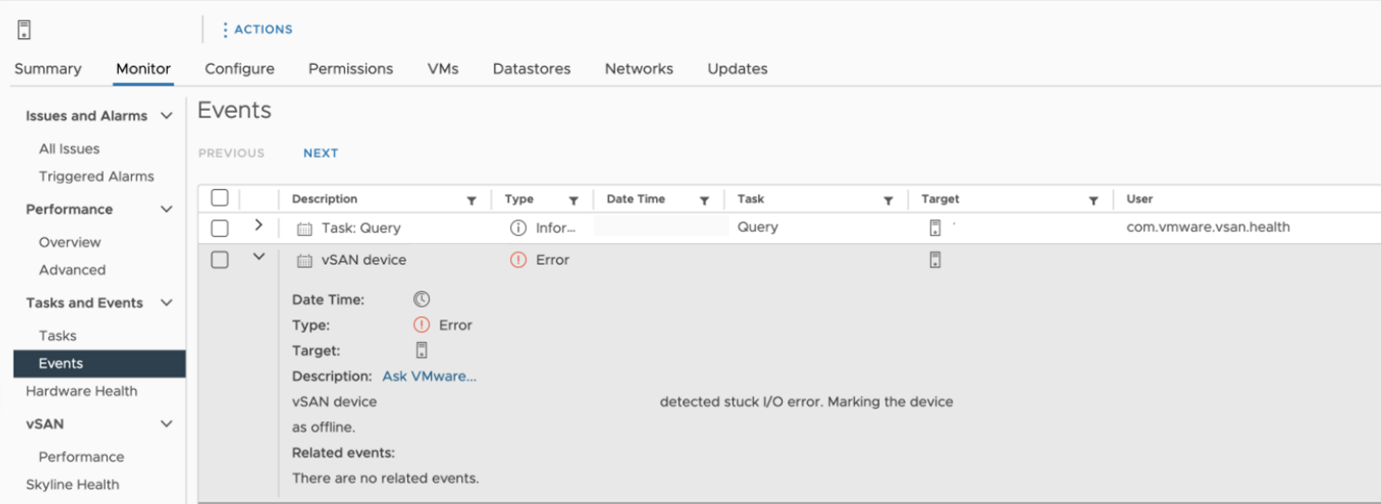

If such a lost I/O is found on a host, vSAN will offline the disk to ensure that it doesn't affect other hosts on the cluster as seen in /var/run/log/vobd.log:
YYYY-MM-DDThh:mm:ss.000Z: [vSANCorrelator] 19607827057us: [vob.vsan.lsom.stuckiooffline] vSAN device ########-########-####-####-####-############ detected stuck I/O error. Marking the device as offline.
YYYY-MM-DDThh:mm:ss.000Z: [vSANCorrelator] 19607829404us: [esx.problem.vob.vsan.lsom.stuckiooffline] vSAN device ########-########-####-####-####-############ detected stuck I/O error. Marking the device as offline
