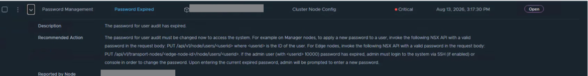

  • An alarm for root/admin/audit password expired is presents in the NSX UI on the following components:
    • NSX Manager
    • NSX Edge Node VMs

  • The following messages are seen when accessing the NSX appliance (via console login or SSH), when the password for that account has expired:
You are required to change your password immediately (password aged)
Changing password for root.
(current) UNIX password:
New password:
Retype new password:
