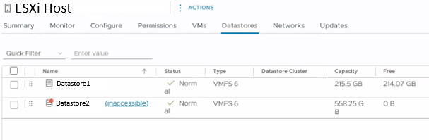

  • Datastore is shown as unavailable in the Storage view
  • Web Client shows error "the datastore is not accessible"
  • Datastore shows 0B and is not accessible (= inaccessible)

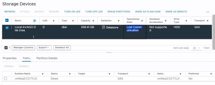

  • A storage adapter indicates the Operational State of the device as Lost Communication.
  • All paths to the device are marked as Dead.
