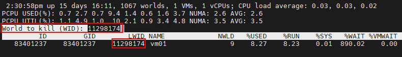

Killing a virtual machine using esxtop is equivalent to a forced hard shutdown with esxcli.
esxtop
