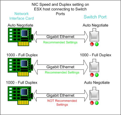

ESXi recommended settings for speed and duplex while connecting to a physical switch port are listed below. Keep in mind the hardware vendor is the best vendor to recommend specific parameters for NICs.
Auto Negotiate

The advantages of utilizing auto negotiation on Gigabit-Ethernet Interfaces
Auto negotiation is recommended on ESXi Ethernet Interface cards and physical switch ports for these reasons:
  • Although hard coding the speed and duplex will work and is in the documentation, in some cases there are performance issues in ESXi. Setting the configuration to Auto Negotiate resolves these performance issues.
  • It resolves issues with iSCSI, vMotion, network performance, and related network issues.
  • Duplex settings: While Cisco devices only support full duplex, the IEEE 802.3z standard does have support for half duplex Gigabit-Ethernet. Because of this, duplex is negotiated between Gigabit-Ethernet devices.
  • Flow Control: Because of the amount of traffic that can be generated by Gigabit-Ethernet, there is a PAUSE functionality built into Gigabit-Ethernet.
Note: The PAUSE frame is a packet that tells the far-end device to stop the transmission of packets until the receiver is able to handle all the traffic and clear its buffers. The PAUSE frame has a timer included, which tells the far-end device when to start to send packets again. If that timer expires without getting another PAUSE frame, the far-end device can then send packets again. Flow Control is an optional item and must be negotiated. Devices can be capable of sending or responding to a PAUSE frame, and it is possible they will not agree to the flow-control request of the far-end.
Fast Ethernet – 100 / Full 100 / Full: VMware recommends forcing the network adapter on the ESXi server host and the physical switch port to which it connects to 100 / Full when using 100 Megabit links with an ESXi server host.
