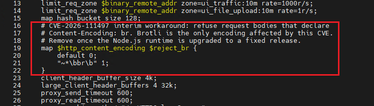

Step 2: nginx rule (covers the :443 path)
  1. Edit the file /etc/nginx/nginx.conf.
  2. Add the map in the http { } block.** Put it after the line "map_hash_bucket_size 128":
        # CVE-2026-111497 interim workaround: refuse request bodies that declare
        # Content-Encoding: br. Brotli is the only encoding affected by this CVE.
        # Remove once the Node.js runtime is upgraded to a fixed release.
        map $http_content_encoding $reject_br {
            default 0;
            "~*\bbr\b" 1;
    Sample Result after the edit (Note: Command used less -N /etc/nginx/nginx.conf):

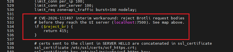

  3. Add the check in the server { listen 443 ssl; ... } block.** Put it just before the # certs sent to the client in SERVER HELLO... comment, after the limit_req line:
            # CVE-2026-111497 interim workaround: reject Brotli request bodies
            # before they reach the UI server (localhost:7500). See map above.
            if ($reject_br) {
                return 415;
    Sample result after the edit (Note: Command used less -N /etc/nginx/nginx.conf):

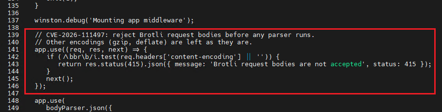

Step 3: UI server check (covers the direct :7500 path)
nginx cannot see requests sent straight to 127.0.0.1:7500. This step closes that gap.
  1. Edit $APP (/opt/vmware/vcf/sddc-manager-ui-app/server/src/servers/sddcManagerServer/app.js).
  2. Find this line (around line 142):
    winston.debug('Mounting app middleware');
  3. Add the block below it, before the app.use(bodyParser.json({... call:
       // CVE-2026-111497: reject Brotli request bodies before any parser runs.
       // Other encodings (gzip, deflate) are left as they are.
       app.use((req, res, next) => {
          if (/\bbr\b/i.test(req.headers['content-encoding'] || '')) {
             return res.status(415).json({ message: 'Brotli request bodies are not accepted', status: 415 });
          next();
    Sample result after the edit:

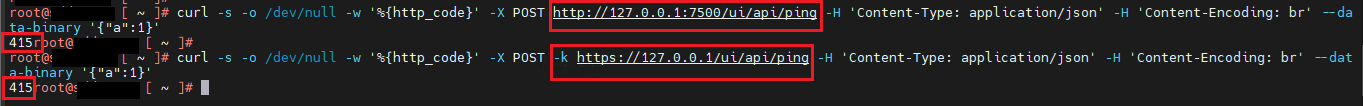

Step 4: Verify
  1. Run these on the SDDC Manager
    TestCommandExpected after the fix
    Brotli body, direct to UIcurl -s -o /dev/null -w '%{http_code}' -X POST http://127.0.0.1:7500/ui/api/ping -H 'Content-Type: application/json' -H 'Content-Encoding: br' --data-binary '{"a":1}'415
    Brotli body, through nginxsame command with -k https://127.0.0.1/ui/api/ping415
    Plain JSON, through nginxsame command without Content-Encodingnot 415 (normal response, e.g. 401 or 403 if not logged in)
    gzip bodysame command with -H 'Content-Encoding: gzip' and a gzip bodynot 415
