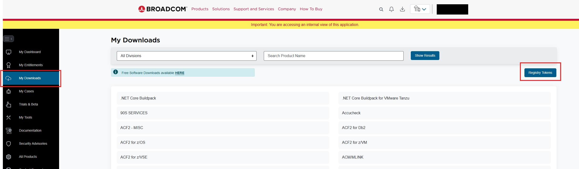

1. Generate a Registry Token: Navigate to the and generate a token. Your token remains valid for the duration of your active support contract.
