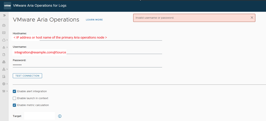

  • When you attempt to configure VMware Aria Operations for Logs to send notifications and metrics to VMware Aria Operations using VMware Identity Manager (VIDM) / Active Directory user accounts, the integration fails.
  • You will observe the following error message during the integration attempt: Invalid username and password.

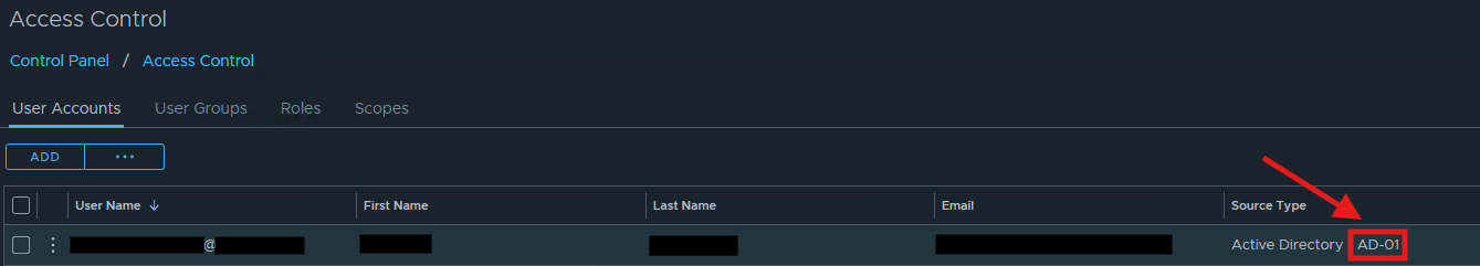

1. In the VMware Aria Operations UI, go to Administration > Control Panel > Access Control.

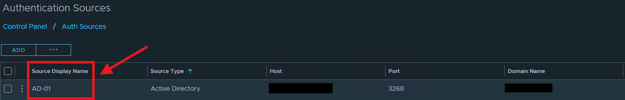

2. Identify or create the integration user. Note the User Name and Source Type fields. For example, a user named [email protected] from the source type Active Directory AD-01
 AD-01 is the Source Display Name shown in  Administration > Control Panel > Authentication Sources.
3. In Aria Operations for Logs UI > Integrations > VMware Aria Operations, enter the username as a combination of the User Name and Source Display Name. For example, [email protected]@ad-01.
Ensure that the integration user account has the proper permissions to manipulate objects in VMware Aria Operations. For more details on required permissions, please refer to the Requirements for Integrating With VMware Aria Operations documentation.
