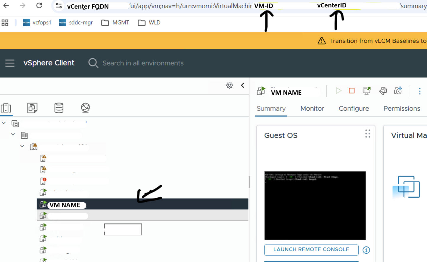

1. Identify the targeted VM's vCenter Server ID and VM Managed Object Reference ID (MoRef ID / vmoid) from the vCenter Server UI. The resulting string format will be <vCenterID>_<vm-id>.
