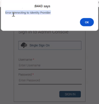

After the upgrade when you click on Sigle Sign-on you get the following error:
<wasp_ip/hostname>:port saysError connecting to Identity Provider
