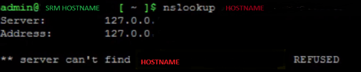

3. Error: (On Step 3)
OR
Cause:
  • SSH not enabled on VR/SRM appliances
  • Hostname resolution failure (direct lookup failed)
Resolution:
  • Enable SSH on VRMS and SRM appliances
  • Add VR/SRM FQDN and IP to /etc/hosts
