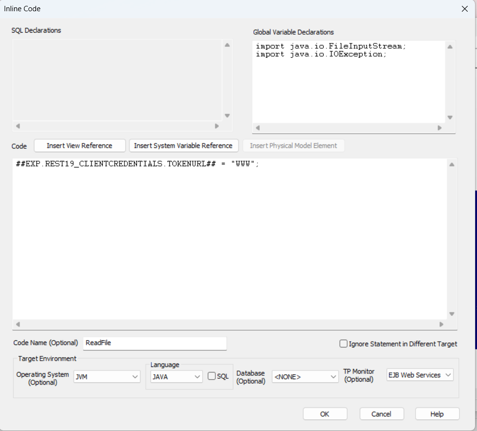

Using Gen 8.6 Toolset created an Action Block with a Java Inline Code statement.

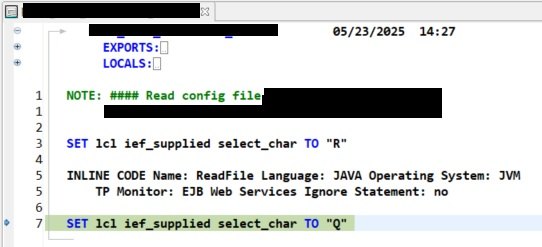

However at runtime using the DTU (Diagram Trace Utility) the statement doesn't execute. Only statements before and after the Inline Code statement execute.
The single Inline Code statement populates an export view:
A screenshot from the DTU:
Lines 3 and 7 execute but not line 5.

With latest 8.6.4 Consolidation PTF WKS86400 installed Support created a test model with similar action diagram inline code to the user and called it from a PStep which was deployed as EJB Web Service to WebSphere.
Started the DTU and using SoapUI executed the PStep. The DTU showed that the export view was populated by the inline code.
As user sent a screenshot of DTU without expanded views perhaps they think the DTU should show the actual inline code statement being executed and that is why they think the inline code did not execute.
The DTU does not show inline code statements being executed but the export view should have been populated as per above.
Support's 2nd statement in the inline code to print a line to the system out/console was also visible in the WebSphere SystemOut.log:
[5/26/25 12:00:32:148 AEST] 000000b4 SystemOut     O Executing inline code statement
