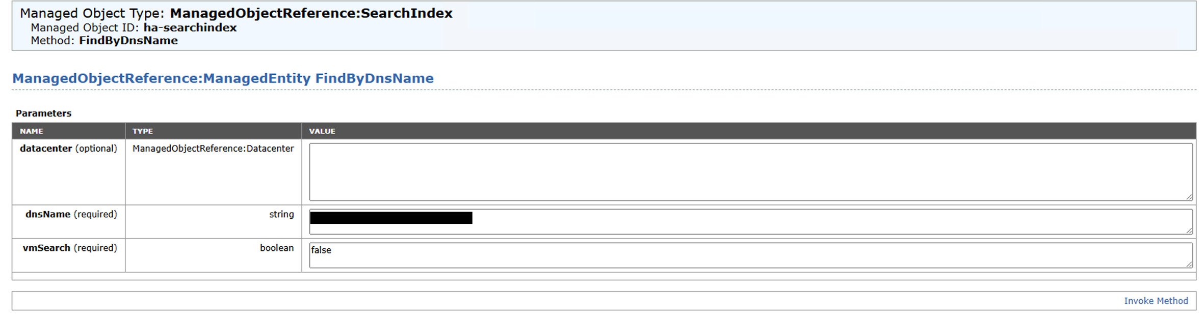

This issue occurs due to a mismatch between the DNS name of the ESXi host recorded in SDDC Manager and the DNS name actually configured on the ESXi host.
To successfully set the NTP configuration on the SDDC Manager, ensure the ESXi host's hostname is consistent across both the SDDC and the host itself.
esxcli system hostname get
https://<ESXi FQDN>/mob/?moid=ha-searchindex&method=findByDnsName (Provide the details below and proceed with Invoke method)datacenter - emptydnsName - <ESXi FQDN>vmSearch - falseesxcli system hostname set --fqdn=<esx_host_fqdn>
