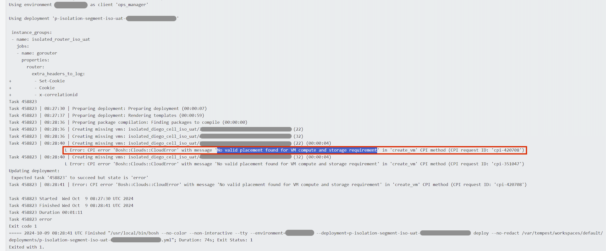

When running Apply changes against any tile on TPCF, it fails with "No valid placement found for VM compute and storage requirement" as below -
L Error: CPI error 'Bosh::Clouds::CloudError' with message 'No valid placement found for VM compute and storage requirement' in 'create_vm' CPI method (CPI request ID: 'cpi-156849')
