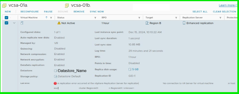

1. Reconfiguring legacy replications to use enhanced replication fails with the error -
A replication error occurred at the vSphere Replication Server for replication 'Repl-Test'. Details: 'No connection to VR Server for virtual machine Repl-Test on host esxi.lab.local in cluster Source Site in cloud: Unknown'.
2. You can create NEW replications to use Enhanced mode.
3. You can also flip from Enhanced replication to Legacy replication mode.

Software code in the replication appliance has a fault that needs to be updated.
ALERT: This issue has been fixed in vSphere Replication 9.0.2.1 | 04 DEC 2024 | Build 24404698
Workaround
1. Reconfigure the replication to use Enable network encryption for VR data in Legacy mode
2. Reconfigure the replication to use Enhanced replication mode
NOTE: Reconfiguring replication with these options in one go will fail with the same error.
