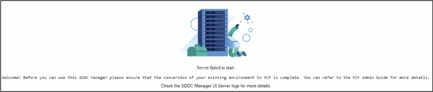

  • SDDC UI shows following message after its reboot.
    Server failed to start.
    Welcome! Before you can use this SDDC Manager, please ensure that the conversion of your existing environment to VCF is complete. You can refer to the VCF Admin Guide for more details.
    Check the SDDC Manager Ul Server logs for more details.
