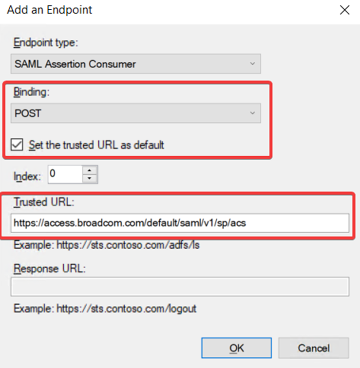

  7. Select the Add SAML option, and add the following Endpoints -
    - https://access.broadcom.com/default/saml/v1/sp/acs
    - https://access.broadcom.com/default/saml/v1/sp/acs?sp=53359bda-9a9c-4264-a114-9a246544c372

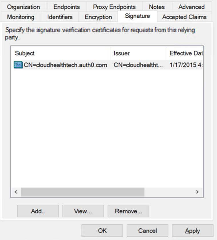

  8. Navigate to the Signature tab -
    You will find the Certificate references CN=cloudhealthtech.auth0.com
    Remove the Certificate as it will need to be updated to the Certificate for Authhub

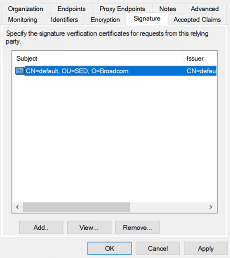

    Add the following Certificate by:
    1. Copy the value above into notepad.
    2. Save as AH.CER into a directory
    3. Select Add -> and select the AH.CER file from the directory.
  9. The Signature tab should now appear as -

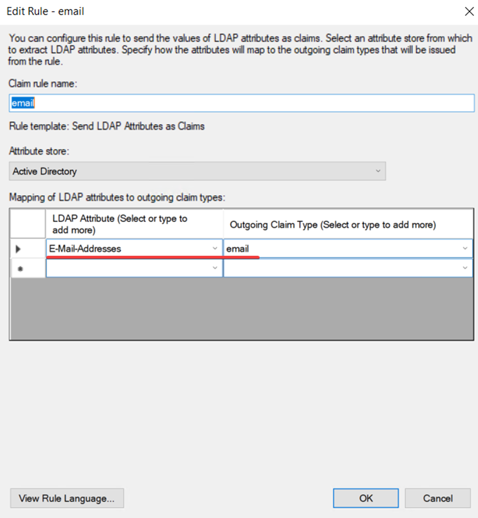

  11. Confirm the changes and hit apply. Right click the Relying Party Trust and select Edit Claim Issuance Policy -
    Ensure that the email claim is setup as the following by selecting the rule, and selecting edit rule
    If the outgoing claim type is set to another value, overwrite it by typing email”
    If you need to create this claim rule, select Add Rule -> Send LDAP Attributes as Claims, and specify a name and populate the values in the screenshot above.

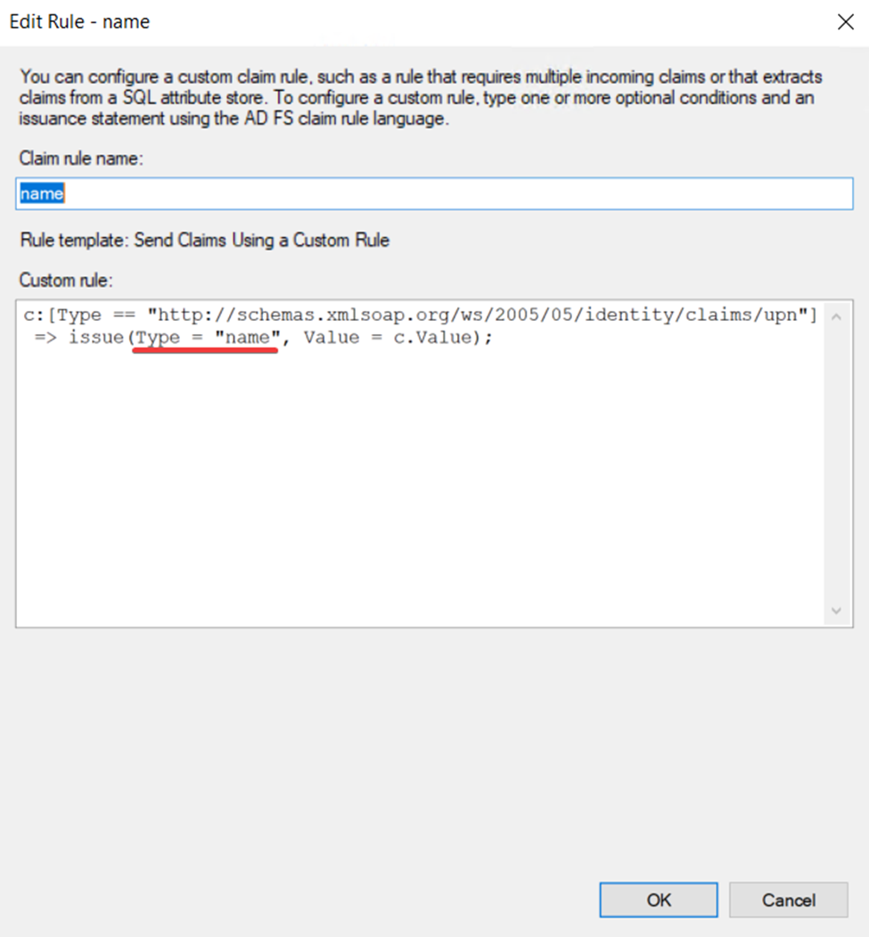

  12. Edit the Name claim, the following example uses “upn” as the source attribute -
    No matter what attribute you’re using as the source, ensure that the Type under the => issue portion of the rule is set to name, and does not include a namespace -
    See following examples of Display Name, and Windows Account Name below also -
    Windows Account Name -
    c:[Type == "http://schemas.microsoft.com/ws/2008/06/identity/claims/windowsaccountname", Issuer == "AD AUTHORITY"]
     => issue(Type = "name", Value = c.Value);
    Display name -
     => issue(store = "Active Directory", types = ("name"), query = ";displayName;{0}", param = c.Value);
    UPN -
    c:[Type == "http://schemas.xmlsoap.org/ws/2005/05/identity/claims/upn"]

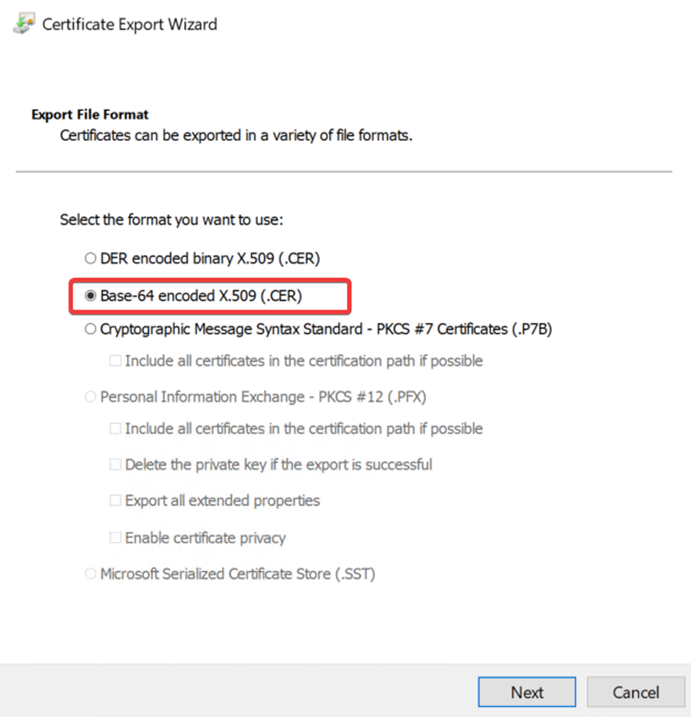

  16. Under the Certificate Export Wizard select Base-64 encoded X.509 (.CER) option -
    Select Next
  17. Set a Path for the Certificate -> and hit Next and then Finish on the next page.
